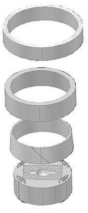

A simple design for the working fixture was retained. The central bar block is enclosed in a set of four jaws constrained by three concentric rings. The first two of these rings have corresponding conical surfaces, so that circumferential constraining stresses are generated by pressing axially the external collet on the internal one.
Figure 3
A third cylindrical element is added for security, hot mounted to develop interference fit upon cooling down.
In very special cases where objections could be raised to the fact that the standard means described above might be insufficient to contrast shattering forces developing in the die, two different solutions could be explored. The first alternative refers to special shapes of the bars providing an interlocking action; the second to external means to be employed to contain such forces.
In the composite die example, the impression consists of half a sphere attached to two cylindrical axial sections. In Figure 1, showing an assembled composite die, some of the outermost bars were sectioned to present a continuous surface to the jaws, either between two opposite edges, or between the middle of two opposite faces.
Figure 2 shows the composite die with an exploded view of the fixture, while Figure 3 is a precursor impression of the die showing an assembly arrangement.
